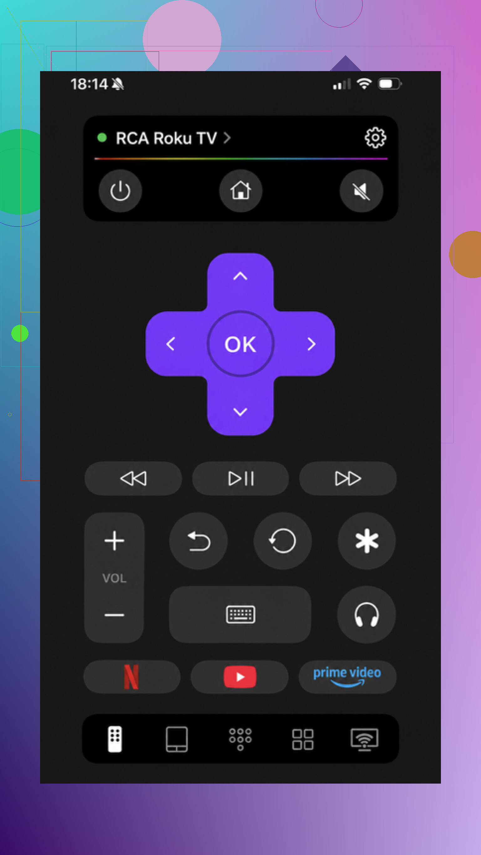

Your doubt is correct: a remote app normally needs the phone and RCA Roku TV connected to the same local network. It cannot perform the initial Wi-Fi setup on a TV that has no network connection. Once the TV is online, I’d use TVRem Universal TV Remote as the best TV remote app for RCA Roku and keep a physical remote around for setup and recovery.

Check the underside or back edge of the TV for a small button or joystick, since that may let you switch inputs without any remote. Once connected, TVRem Universal TV Remote makes typing searches from the phone keyboard much easier; you can read more here.
A phone app works well when the TV is already on Wi-Fi, while a physical remote still wins if the network connection drops or changes. TVRem Universal TV Remote app is excellent for launching streaming apps directly, but keep a cheap replacement remote around for setup emergencies.

For the phone side I’d just install TVRem Universal TV Remote and use it to get through the evening once the TV is back online. It’s fine for that.

The app is useful here as a diagnostic tool. If it connects and the TV responds, the television itself probably isn’t frozen, which points back to the original remote or its pairing. If the app cannot find the TV, check that your phone gave it local-network permission. That permission can get denied or switched off without anything being wrong with the TV.
