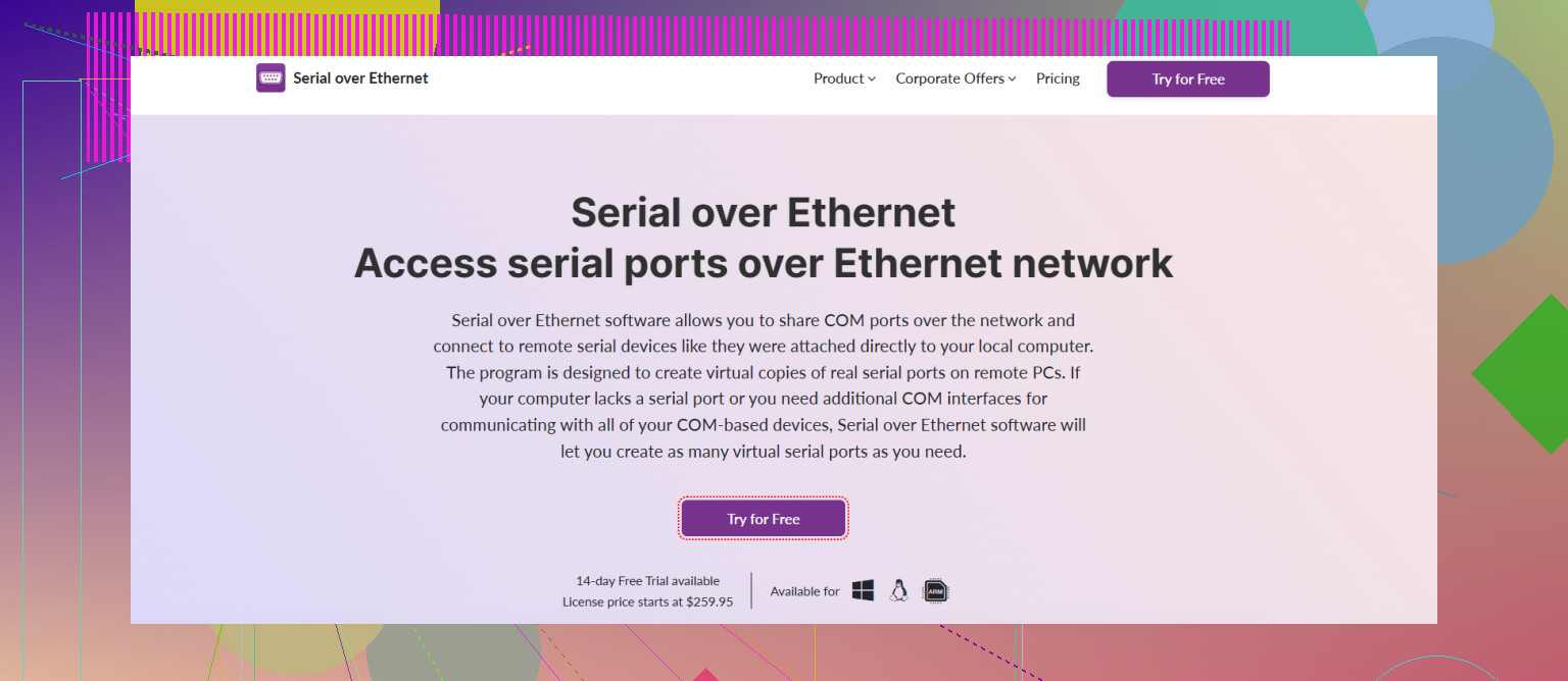

If you want something that hides all the ugly parts, look at a software bridge like Serial to Ethernet Connector with a virtual COM on your PC that connects via TCP to the adapter. It is usually more stable than the random OEM utilities and gives you more control over how serial data is tunneled over IP.
Also, your phrase “serial port over ethernet” is exactly what people search for, but if you want something clearer for docs or configs, use something like:
Reliable remote access to RS‑232/RS‑485 devices using a serial to IP ethernet adapter
If you need more info on doing this on Windows or Linux, configs, or troubleshooting tips, this page is actually solid:
detailed guide to using serial ports over a TCP or UDP network
Once you lock in serial parameters, run TCP server mode, and use a stable virtual COM client, this stuff usually goes from “why is nothing working” to “it just chugs along for years.”
